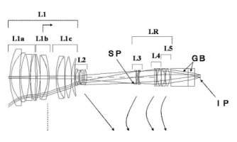

A patent showing a Canon 10-120mm f/1.8 lens for a 1″ sensor has become public. Such an optical formula may be a remanent from the XC10 development or could appear in a future video camera product. I’m sure a lot of people would have rather seen an f/1.8 lens in the XC10, instead of the f/2.8 lens it comes with.</p>
<p>Patent Publication No. 2015-75523</p>
<ul>
<li>Published 2015.4.20</li>
<li>Filing date 2013.10.7</li>
</ul>
<p>Example 1</p>
<ul>
<li>Zoom ratio 11.54</li>
<li>Focal length 10.21 56.31 117.88</li>
<li>F number 1.87 1.79 1.78</li>
<li>Half angle (in degrees) 38.07 8.09 3.88</li>
<li>Image height 8.00</li>
<li>Overall length of the lens 555.0</li>
<li>BF 16.56</li>
</ul>

The overall length is around 555mm or about 22 inches. For comparison, the 600F4L is 448mm, the 800f5.6L is 461mm, and the 1200f5.6L is 836mm. That's a pretty big lens and a lot of glass for such a small sensor.
It does sound like a broadcast lens. Many broadcast cameras use 2/3 sensors, so the standard may jump to 1 inch.
In any event, it sounds pretty amazing, and likely to cost North of $30,000. I realize that not all patents actually result in production. This one is a obvious candidate for a DO treatment.
Mt Spokane Photography said:
With the 2.7 crop factor for a one inch sensor, that's a FOV equivalent to a 27- 324mm FF lens. At f/1.8, that's quite a lens even though it is a small sensor, it will be pretty big and expensive..
Note, its not equivalent to a 27-324mm f/1,8 FF lens. It equivalent to a 27-324mm f/4,86 FF lens. Still quite impressive.

I did not say the aperture was equivalent, I said FOV (Field of view) However, the Aperture is f/1.8, not f/4. What you are referring to is depth of field calculations. For setting exposure, its still f/1.8.

I was referring to DoF, total exposure in terms of # photons in total image, total photon noise in terms of RMS per image size or fraction of image size. I could also include diffraction effects but thats not very prominent in this case.
I know the aperture is focal length / 1,8 but focal length is a smaller number then an equivalent FOV lens for a larger sensor. Thus the absolute aperture is smaller, causing these effects.
If I crop away 75% of a Bird in Flight shot, the Bird doesn't get darker.
Correctly metered and focused, an f/1.8 lens projects focused light in the shape of a bird across a few millimetres of an image plane, regardless of what's going on on the rest of the sensor, or if the sensor is even... there.
You could also include your zip code and underwear size but that's only as relevant as all the other redundant data you're bringing to the table... "IMO".
If you mount this on an a7r it's going to focus just as many photons in the shape of a bird with the same projected dimensions as it would on a 1"-type sensor.

The 1" sensor is just a little bigger than super 16 film (12.52 x 7.41 mm)

what are the dimensions of 1" sensor? Assuming a 2x3 axial ratio I get 0.55" x 0.83" or 14 x 21 mm.
Is that correct?
Its a oddball computation, and hardly related to 1 inch.
Wikipedia has a table of dimensions and the history of how they came to be so bollixed up.
They list the Sony 1 inch sensor as being 13.20 X 8.8mm. However, a camera may not use all of the photosites in a sensor, so that can throw off any assumptions.

I'd assume the dimensions we both mentioned (Sony's?) are too great for this lens to make use of and smaller sizes do indeed get the 1" branding... I've not clicked back to check but I'm pretty sure the patent suggested the projected image's height was no more than 8mm!
