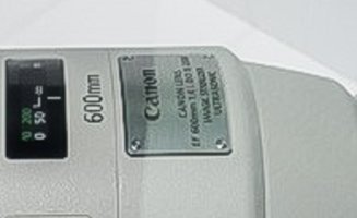

compupix said:
You should have made the red line green. Canon's DO lenses have a green line.
Who should have made it green? That photo is Canon's prototype of the casing they showed last year. And in some of the photos you can read the actual name plate and Canon named it " EF 600mm 1:4 L DO IS USM " So Canon is pushing this DO into the L range....green ring be gone....this ones gonna be fire engine red 8)
IMO, they should have made the 400 DO II the 400 L DO IS because it leaves the old 400DO in the dust and belongs in the L range of superteles
