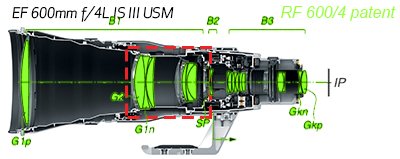

It looks like Canon is indeed working on their RF mount super telephoto optical formulas. We were told a couple of days ago that an RF 500mm f/4L IS would be the first super telephoto lens launched for the EOS R system.
A USPTO patent has appeared that shows optical designs for an RF 400mm f/2.8L IS, RF 500mm f/4L IS and an RF 600mm f/4L IS.
Canon RF 400mm f/2.8L IS USM
Focal length: 392mm
F number: 2.9
Angle of view: 3.16°
Image height: 21.64mm
Entire lens length: 360mm
Backfocus: 31mm
Canon RF 500mm f/4L IS USM
Focal length: 490mm
F number: 4.12
Angle of view: 2.53°
Entire lens length: 412mm
Backfocus: 33mm
Canon RF 600mm f/4L IS USM
Focal length: 588mm
F number: 4.12
Angle of view: 2.11°
Entire lens length: 476mm
Backfocus: 33mm

Also interesting that the RF 600mm f4 is longer than the EF versions, 476mm versus 448 ( III ) and 457 ( II ). Which might not seem a lot but does complicate finding an appropriate carry-on-friendly backpack, for example.
Actually on further research they're all longer than the EF variants.
The RF versions would actually be shorter than their EF counterparts. In a patent request 'entire lens length' means from the front-end of the first element to the sensor: a patent is not linked to a specific mount / flange focal distance.
You should therefore add 44mm to the length of the EF lenses to make your comparisons.
To compare lens lengths, one should instead subtract 20mm from the RF patent length. Doing so based on the above measurements indicates the lenses are essentially the same length.
Still not seeing the purported ‘benefits of the RF mount’.
shouldn't see any advantage really except perhaps a better balance on an RF super telelphoto.
as we originally discovered with this patent last thursday, about the only change is a shifting of the elements closer to the back.
True, but not RF-specific. That same sort of shift was done in the EF 600/4 III – moving the lens groups behind the front element closer to the mount, which allows them to be smaller in diameter (= lighter), and shifts the center of mass toward the body (= better balance).
similar, yes, but not as much. This shift was RF specific. the shift was around 40-50mm more than what you see on EF super telephotos, which is why we identified these as RF super telephoto patent applications.
It seems obvious they are RF patents based on the 31-33 mm back focus distances specified in the patents.
Based on an appropriately-scaled overlay, the second group back from the front element (G1n) sits ~6mm behind the corresponding group in the 600/4 III, and the next group back is ~12mm behind the corresponding EF group.
