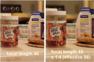

Just tried it with a 1.4 teleconverter and yes, the DOF changes and gets shallower. There are indeed some online links that say no, it doesn't change the DOF, but many others that say yes it does.
Attached is a file with two pics - one with and one without 1.4 teleconverter showing the change in DOF.

DOF is determined by two things, subject magnification and absolute aperture (that is the actual size of the hole of the aperture not the f stop number).
If you keep the distance the same the magnification is bigger with the TC and the aperture is the same physical size, ergo less DOF. If you moved back so the magnification was the same with the TC then the DOF would be the same because the aperture hole is.
