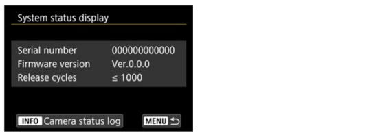

I discovered that the Shutter Count app (available for MacOS) counts the R3’s electronic shutter “actuations/release cycles”. I’ve not used the mechanical shutter once on the camera, but I’ve taken approximately 7,200 Electronic Shutter images. The Shutter Count app reports the shutter count as less than or equal to (<) 8,000.
Interestingly, the R3 itself doesn’t show Electronic Shutter actuations. Going into the R3’s menu (wrench icon, tab 5) and to “System Status Display”, the shutter actuations are shown on my camera as less than or equal to (<) 1,000. This is consistent with my non-use of the mechanical shutter, as actuations are only shown in 1,000-shot increments. In other words, I believe the R3, through its own menu and logging system, is only showing mechanical shutter actuations/release cycles.

Reading the shutter course with an accuracy to a single click is possible only at an authorized Canon service center. Authorized Canon service center on the receipt for the receipt of equipment from repair does not specify the shutter release mode used. How do I know that? I once sent mine R to an authorized Canon service center to check its correct operation, and asked to read the shutter course.
"2875 ZDJĘĆ." equals "2875 PHOTOS."

Question #1:
Could our "System status display" menu be made less ambiguous by displaying "release cycle" numbers for both mechanical shutter releases and electronic shutter releases?
  • Is that something Canon users would value seeing?
  • Pardon my ignorance on the inner workings of a mirrorless camera, or the methodology definition behind counting "releases", but if everything we are doing is being counted (but not necessarily displayed) then perhaps we could collectively reach out to Canon to request that one number be displayed for our mechanical shutter releases, and another number be displayed for our electronic shutter releases. Perhaps they could add that level of detail in a firmware update?
  • As an aside, I suppose we could also flag the nuance that any numbers shown pertain to the camera's usage in photo mode, and not video mode. With that perspective added, perhaps it would also be worthwhile knowing (somehow) the amount of time the camera has continuously operated since its first activation.
    • For example, at present, I rarely use my R3 for video and I like using the mechanical shutter. Yet, I just met someone in my community who told me they seldom use their R3 for still pictures. They noted that upwards of 70% of their business model (and R3 use) is video first and video oriented (and then mostly taking still photos while first filming video). In addition, R1-7D noted that they almost exclusively use the electronic shutter. So, if knowing camera use statistics matters (for different reasons like warranty coverage and resale values), then perhaps all possibilities of camera usage should be accounted for? This distinction between three R3 users leads me to my next question:

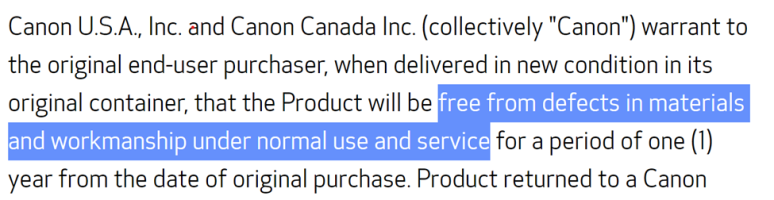

  • All I could find in the "Canon Imaging Products Warranty" fine print was the following note:
  • What "normal use and service" may mean, however, was not clear to me.

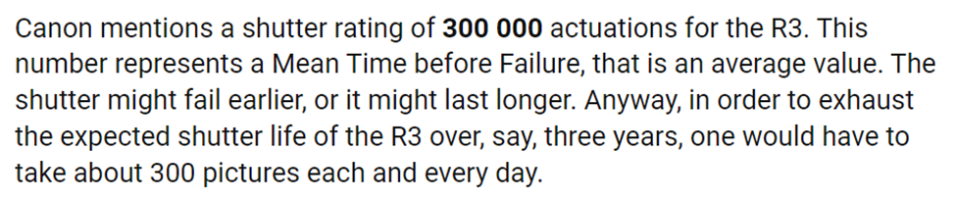

  • While I was unable to find any official numbers, I came across the following idea when googling, "warranty coverage, shutter life expectancy for R3"
Yet, I do not know if the above reference is true, as I was unable to find the alleged claim made by Canon, but I suppose it gives us a ball park idea on what to consider when looking at a "release cycles" values.

I was equally curious about these details, yet mostly from a warranty coverage perspective.
The warranty is based on a fixed time period after purchase, one year in the US. The shutter count is irrelevant as far as the warranty is concerned, so if that’s your perspective just ignore it.
Mechanical shutters have a rating, an ‘expected life’. That’s a guideline and a hint as to the shutter’s robustness, but that’s it. The R3 shutter is rated for 500K cycles, which is very high. But if the shutter fails after 30K cycles 13 months after you bought it in the US, you’ll be paying for the repair, not Canon.
Awesome: 500K is better than 300K! I was unable to find that detail in the spec sheet, but either value sounds very high and good to me. Over a ten year period, I put roughly 250K cycles on my 1Dx, but I seldom burst in the photography I mostly do. As I get more accustomed to the electronic shutter option, I too will probably use less mechanical.

I believe the shutter actuation rating provided by Canon is solely for the Mechanical Shutter. It would not make sense to include Electronic Shutter actuations in that rating.
I suspect that if your Mechanical Shutter fails under “normal” usage within the one-year Canon warranty, Canon would cover the repair. Canon has a reputation of being quite fair and lenient with warranty repair work. Would Canon still cover the repair if you exceeded 500,000 Mechanical Shutter actuations within the year? I’m not sure; as you have pointed out, Canon does not specify what “normal use and service” means.
Additionally, if your Electronic Shutter stopped working within the first year of ownership (regardless of the number of images taken), then that would be indicative of an electronic component failure and be warrantable.
If your one-year warranty has expired, however, you will be responsible for the cost of repair, regardless of whether you have 100 or 500,000 actuations, or you have some other component failure that affects using the Electronic Shutter.
