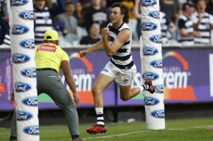

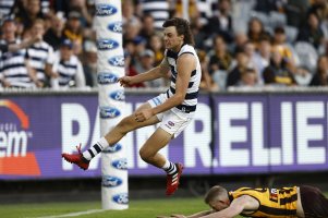

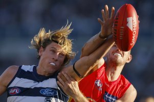

I have thrown out so many unusable frames taken on the R5 electronic shutter. Shots like the following (ball stretched vertically, and the poles/signage in background on an angle). It has made me permanently use the mechanical shutter on the R5 as I cannot submit images like these below (taken on R5).

2 video reviews of R3 stating it is improved, but still evident - actually, only mentioned it is evident but I see it at the starting points I set in the following links (background poles on an angle in dpreview clip, from clip mentioned warped ball):

Sincere question, as rolling shutter isn't something I have more than cursory knowledge of. Are these images truly examples of rolling shutter? Mostly in the last two it seems to me they are not rolling shutter because I would suspect the panning was right to left following the player direction, but the "lean" is left to right. Also the rugby example, the ball does look elongated, but there is no apparent "lean" which in Jared's soccer ball example is slight but still apparent. Thanks, I appreciate any opportunity to learn and understand.
If an object is moving vertically (or horizontally when the camera is held in portrait mode,) the object will appear squished or stretched rather than skewed.

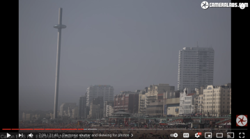

While not sports, so far, I like Gordon's test the best. Much better, according to Gordon, as good as the A1, but still not perfect.
Set to 6:45 where he talks about rolling shutter.
Thanks, skrubol, I think I can visualize it that way regarding the ball. Any insight to the two other examples where the posts are leaning to the right, which if I have it right would indicate panning from left to right. The action, however, is right to left so I am assuming that is the actual direction of the panning motion.
Yes the last two are rolling shutter. If you have a mirrorless camera you can test it out yourself, objects lean that way when panning that way, it must have something to do with how it is read? Although what you say makes logical sense, they actually lean forwards rather than backwards to the way you are panning.
And yes the ball definitely stretches vertically, one of the players' hands is also slightly elongated. This has happened a lot when the action is close, that image was barely cropped in if at all.
I think I got it now. The tilt sort of points to where the camera is panning to, not from. Which makes sense if accounting for the image being inverted as projected on the sensor. Of course that requires an assumption the the readout is from top to bottom.
Thanks folks. I’ll quit while I’m ahead, I got the main point re:direction. The rest I’ll just accept without 100% understanding hehehe
Yeah I saw that one too, the second example of the tower isn't great though is it. I have friends using the A1 say they never notice anything in their work, I was hoping R3 would show nothing.

From the test on Gordon’s video its much improved but still noticeable to the point where the images in his test would be unusable to me personally.
With stacked sensors the readout speed is very key.
