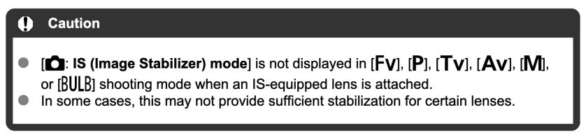

Just where does one turn it off?
I looked at the manual and it says that the IBIS switch will not be visible in the menu if you use AV, TV, M, P, or FV.
As I use only M and AV the menu item never appears.
