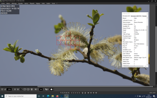

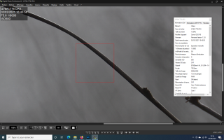

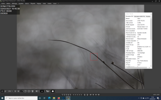

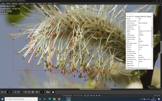

hello every body,
as you may know, i've had trouble with R5 and 500mm EF IS f4 V1, inacurate focus, lens continuesly focusing.
i knew it was no the lens, so i made a factory reset and all was perfect,
but i was waiting this new firmware because i think i will definitly fix possible AF problem.
so i installed it, P mode, no lens, battery ok.
and i test the R5 and 500mm with or without x1.4, also tested 100-500mm RF , and all was perfect , the 500mm f4 focused really fast , tracking was ok, no AF trouble at all.
so i went on the field did a few shots with x1.4, perfect), switch to 100-500mm, perfect, switch to 500mm+x1.4, perfect, 100-500mm, perfect, and back to 500mm+x1.4, and...
impossible to focus, i did not make a change on settings, AF keep tring to focus on subject , but still work perfect with 100-500mm.
i really don't understand.
i made a factory reset, nothing change,
any idea to fix this problem?
thanks .

well, tried and tried the combo R5+500MM f4, V1, still the same , impossible to focus, AF gets close to subject but keeped chaning back and forward...
very frustrating.
what's even more frustrating, is that today, although i did nothing, did not change any setting, the combo works fine,
has any of you experiment such behaviour with any lens on any camera?
Thanks for your help.
