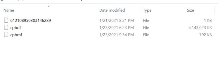

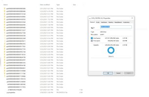

Thanks for all the input. I am attaching a few screenshots. snip1 is a view of the card properties per Win10 and the cpbf folders. Snip2 is what is typically in one of these cpbf folders. Snip3 is part of what is in the DCIM folder. This card was used and formatted before this time and did not seem to have this problem. I will format in my computer, then format in camera and try it again to see if the issue recurs. I've got my second CFExpress card in the camera now. Of course, it is a rainy, crummy day and a week of work is coming up, but I'll see if: a) Reformatting this card changes how it functions and b) If the second card acts differently.
