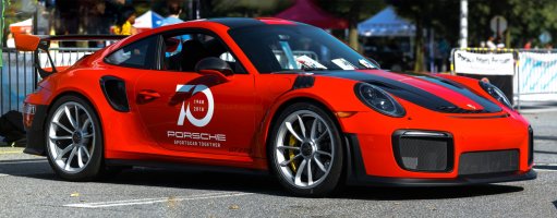

Technically reds can be difficult on all regular Bayer array sensors because the red channel normally clips first which means you get blocks of red rather than subtle tonal transitions, just watch your RGB histogram for clipped red channel issues. The hue is easily and very quickly dealt with by using a ColorChecker passport, no guesswork, no wasted time, just accurate color.
The car above is a perfect example of clipped red channel blocking, open it in PS or LR and run the dropper tool over it and see how much of it is red channel 255, way too much.
If it is too much, it is deliberate. I wanted to match my memory of how I thought I saw the car; which of course is subjective. But I'll give your advice a shot.
I'm certainly not criticizing, merely trying to point out a different way to process so there is no need to "Really had to spend time in post to get them right." If we can't help each other out with stuff other than how fast the R5 overheats then the forum will be a very negative place! :)

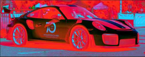

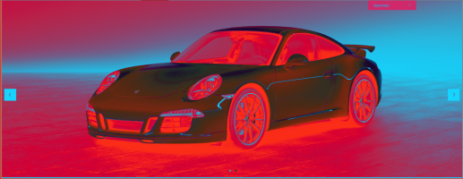

If you put it into Photoshop and make a colored fill layer on top with red at 255 and set the blend mode to 'difference', in an optimally exposed red channel image you will see a little black but mostly gradations, you don't want blocks of black.
It will look like this. Small black patches on the tops of the fenders hood, C-pillar etc but quickly fading to nice gradations.
With the same fill layer your image looks like this. Large black patches on the three fenders, the hood the roof and the front bumper.

It looks like a big reason for the red clipping in the Porsche photo is because it has been shot in direct sunlight. The official porsche picture is under studio lights which would no doubt be much softer than direct sun and would have allowed for those gradations in the paint.
No, the light source is irrelevant the exposure is the important part whatever the lighting and for a very saturated color it is critical to look at the channel histogram to get the optimal exposure. The studio shot will have had complete control over the lights that is true, but the blended layer illustrates that they created that light and subsequent exposure optimally for their red channel.
Put another way, in the studio they had complete control over both the lights and exposure, for the sunlight shot you can only control the exposure, ergo any problem is an exposure problem.
