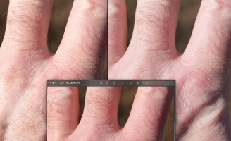

Here's another one I just shot, and the left one is raw with "adobe" color profile, the right one with the new ColorChecker profile and the bottom center is jpg SOOC, all of them at the same exact wb. So the JPOG out of camera should be the same as my starting point in DPP, no?
To me it almost seems like it is not correct with adobe, but it's closer than with the CC which makes no sense unless there are some issues with the CC software. It also puzzles me that When I use the CC to eye drop WB it always adds a ton of magenta, out in daylight no which is pretty cool light since it's winter, and still adds +28 magenta tint.
Earlier there was an Adobe software called DNG profile editor whvih I could use to make CC profiles, but is that no longer available? I couldnt find it. Just to check if that gives a different result.
LrC is not supporting M1. I will download Lr CC and try that also to make sure. And I will contact X-rite to see what they can help with. Thanks"
