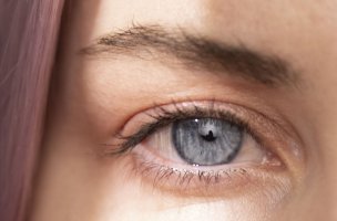

Today I updated my R5 with firmware 1.1.0 but have run into a problem. Images taken with my RF 85mm f1.2 are no longer sharp. It almost appears as if the image stabilisation is no longer working properly. Shutter speeds are 1/125 and 1/160 and at the point of focus it just isn't as sharp as it was with firmware version 1.0.0. Very strange!
Has anyone else run into this problem? I'm going to try a fresh re-install of the firmware and see if that helps... otherwise I will be contacting Canon to let them know something isn't right.

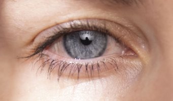

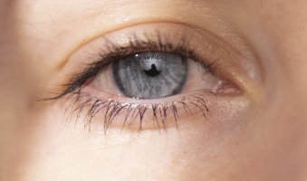

Thanks very much for your reply. This is all very interesting. So far I have only tested at 1/125 but will now test at other shutter speeds, both slower and faster to see what's going on.
The shutter was set to fully mechanical in the firmware version 1.1.0 photo above, but I believe the 1.0.0 photo was with EFCS. So that may indeed be the difference.
