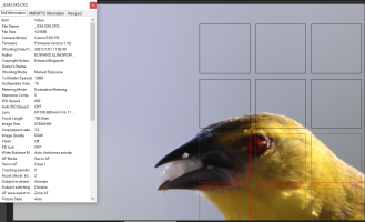

I recently obtained a R5 but seem to be struggling with noise shown in the RAW file in LR even for low ISO (e.g. ISO 800). The same image on DPP shows hardly any noise. I also tried converting to DNG and importing that to LR but it still shows too much noise. Below is the .CR3 image on LR at 100% showing noise followed by the same image in DPP showing less noise. Is this a LR or R5 issue? Do I need to run all images through DPP (export to JPG) before editing in LR? (I use Manual Auto ISO). Please help.

I don't use DPP so can't make recommendations regarding that, but in the DPP sample you provided there is a lot of noise reduction being applied. Significant feather detail has been lost in the process, it looks pretty bad imo. You might get a good result using DPP as a first step, but I personally find it slow and cumbersome to use so I couldn't tell you how.
Large areas of solid color like the background in your photo will show noise much more than a "busy" section of an image. It also appears that the shadows have been lifted to a greater degree in the LR example, which also adds to the appearance of noise. Still, depending on the rest of the image, a background like what is shown is super simple to clean up.
The LR version is not bad and you could probably improve it quickly with judicious use of the noise reduction sliders. Personally, for that example, I would run it through DxO PL5 first, then import the DNG into LR. That is not by any means required for all photos, just certain cases. Depending on whether you use Lightroom to catalog/manage your photos, you may not even need LR if you had PL5. Topaz Denoise would also fix that right up, works as a LR plugin, but I more of a one trick pony.

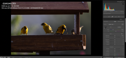

Thanks Henry. What you say makes sense. I am at that stage of fearing noise resulting in underexposed images. Here's the uncropped and histogram taken back to original settings. Definitely under exposed. I had to increase exposure and shadows on LR to make the image more acceptable. I'm learning a few lessons here. Thank you.
You'll get less noise by just going ahead and raising the ISO when shooting so that you don't have to raise exposure in post. That's the best way to shoot unless you're keeping the ISO lower to protect from blown highlights that might be in the scene.
(For example, when I shoot sports I tend to underexpose the mids by about half a stop or so to prevent blowing out the brightest spots on the white jerseys that are almost universally worn by one of the two teams in most sporting contests here in the U.S. I then raise exposure in post while pulling the highlights to keep them from blowing. If I shot it at higher ISO they'd be too blown to recover in post.)

Your cropped image vs. your uncropped image shows a pretty major crop, so I'm not surprised by the noise, especially since the image was underexposed.
You can get similar noise reduction from Lightroom (Actually I use Camera Raw, but it's the same thing) as the DPP file, depending on how far to the right you move the noise reduction slider. How much noise reduction did you apply in Lightroom? In either case, you will sacrifice detail for noise reduction. It's a balancing act and you have to move the slider until you reach the balance of noise vs. loss of detail that you find acceptable. It looks like the DPP image just has a WHOLE lot more noise reduction applied.
Generally speaking, I've found that Canon's newest sensors (I use an R5 and a 1DX III) perform pretty spectacularly at higher ISOs. Indeed, when I'm in a hurry to process pictures from a sporting event I often forget to apply noise reduction in Camera Raw to files at 6,400 or below and don't get much noise even with default settings. But, then I am generally not making massive crops and most of my images get downsized to about 1140 px for the web and social media. I also take care not to underexpose.
There are a few things you can do to reduce apparent noise. Noise is often most visible in out of focus backgrounds and skies. With Lightroom or Camera Raw, use the new masking tool to select the subject and then invert that selection so that everything but the subject is selected. With that, you can apply some pretty radical noise reduction to the background without impacting your subject. In the example you are showing, all that noise in the sky can easily disappear with no harm done, since there is no detail there anyway (and you really wouldn't want detail there even if there were some.) Oftentimes, simply eliminating the noise in the background will give you acceptable results, because eyes will often tolerate more noise in the subject than in a blurred background.
Of course the best things to do are to not underexpose in the first place, avoid extreme crops and don't get caught up in pixel peeping at 100% when no one but you is going to see your image at 100%
