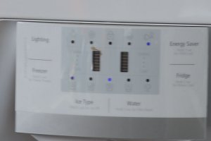

Ok so here is a 100% crop of a photo I took of my refrigerator controls with the RF 50mm at 2 seconds shutter. This was standing, but as still as I could be, holding breath, everything. It is not a miracle feature.

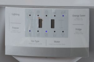

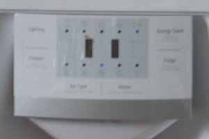

Now for a little more realistic shutter speeds, here are two photos with IBIS on at 1/8 second, 50mm, again 100% crops.
So on the second shot you can see that the IBIS did pretty much nail it. So again, it's a useful addition, but so far it doesn't seem like a miracle to me.

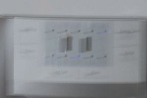

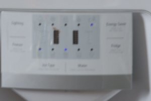

However, here are two photos at 1/8 second with no IBIS. Definitely a lot worse.

Really curious to see other peoples' experience with the RF 50mm and IBIS in the R5. 7 stops of stabilization would be about 2.5 seconds. I'm not seeing anywhere near that in my experience. Honestly I'm a little put off by this. I'm seeing like maybe 3 stops, hit or miss. :mad:
Thanks for posting some actual results.

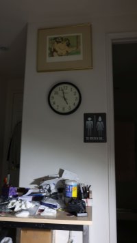

I was messing around and took a picture at ISO 100 at f8 and dim room light using a 24-70mm f2.8 at 30mm updated with the new firmware. The exposure time was 5 seconds and I was surprised at how sharp the picture was. You can see the blur of the second hand which moved during the exposure. I was not making any attempt to hold the camera still but it was a surprise when I looked at the photo. Ignore all the junk on the desk. LOLIMG_0171 reduced.jpg!
