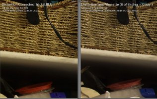

Even on the Mark IV there is still some noise that has been created in the corners after correction. Not bad, but very obvious when comparing the Tamron 15-30 after correction. It's only one copy of each, obviously, but while the Canon has a sharpness advantage in the middle at 16mm vs. 15mm, the Tamron (at least my copy) is clearly sharper in the corners.
