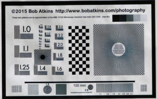

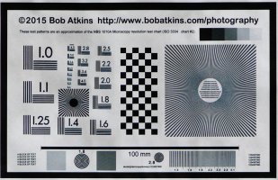

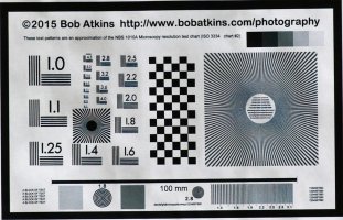

They are just TDP's results with their copies of each of lenses. It doesn't mean that your copies of the lens will be the same. I have tested two copies of the Sigma 100-400mm on my 5DSR vs my copy of the Canon 100-400mm II and my copy of the Sigma 150-600mm C.
http://www.canonrumors.com/forum/index.php?topic=32776.msg667778#msg667778
Here are some results at the centre from each with sharpening with USM (0.9px 100%). The 100-400mm Sigma is the poorest of the three. The new Sigma is quite a good lens, but don't judge how good it is relative to other lenses from one website. You might buy a better copy or a worse one.
AJ said:
but it shows what a good copy can do.
True. And equally true it will show what a bad copy can do. And it is also a fact that, as here, someone then will post that lens A is way better than lens B on the basis of one randomly selected copy of each lens. Lensrentals is the only site that makes valid general comparisons as it looks at many copies of each lens as in:
https://www.lensrentals.com/blog/2016/08/the-sort-of-great-400mm-shootout/
where they carefully compared ten or so copies of each of Canon, Sigma, Tamron, Nikon zooms at 400mm. The site points out there that variation within each group of those lenses is greater than differences between each group.
You can't draw any general conclusions from my tests either. But, my tests stopped me buying the one copy on sale locally, and I will wait until there is a good copy in stock.
