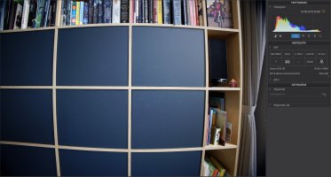

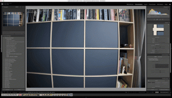

The need for substantial distortion correction was anticipated. How is AF speed and accuracy in low light?
No complaints about accuracy when using it indoors, the AF speed feels a lot faster than the STM 50/85mm primes. About about as fast as the USM used in regular EF-mount lenses, but nowhere near the nano-USM speeds of RF-mount lenses.
The AF speed is better than expected, the 50mm and 85mm lowered my expectations a lot. The distortion and vignetting match my expectations, the corner sharpness, both pre- and post corrections does exceed my expectations.
