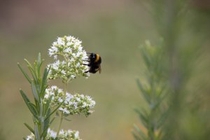

Lets get in close to some bees!
EOS R, RF 24-240 f/4-6.3 IS USM @ 240mm, 1/400s, f6.3, ISO 400
EOS R, RF 24-240 f/4-6.3 IS USM @ 40mm, 1/200s, f4.5, ISO 100
EOS R, RF 24-240 f/4-6.3 IS USM @ 240mm, 1/320s, f6.3, ISO 400
