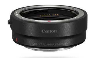

Can we confirm that the announced RF TCs are RF to RF? RF-RF could only be used on the 100-500mm (if new DO super tele is not released soon) and @1000mm f/14 (2x) would have few use cases. They can't fit the RF70-200 due to how close the rear element is to the mount.
If they are RF to EF TCs then it would make some sense ie to avoid RF-EF adapter + EF 1.4/2x TC and use the existing big whites. This would fit the current RF roadmap rumour but wouldn't help with future RF big whites.

This actually makes sense to me (not that that means anything). It would be handy to have TCs that can be mounted to an EF lens and used without having an extra adapter. Although it would be better if the TCs had a control ring.
Only an extra 3mm/20gm for the adapter with control ring vs none. The photo shows external length to be much shorter than the EF TC (and protruding lens about the same length).
It wouldn't make sense to have a control ring on the RF TC and a control ring on the RF lens so that may be one reason to suspect that they are RF-RF TCs.
Adapter ModelDimensionsWeight
Canon Mount Adapter EF-EOS R2.8 x 0.9" (71.2 x 24.0 mm)3.88 oz (110 g)
Canon Control Ring Mount Adapter EF-EOS R2.9 x 0.9" (74.4 x 24.0 mm)4.59 oz (130 g)

Just one more random thought. The picture makes it look like the RF extender sticks out a lot more than the EF extender, but some of that may be an illusion because the RF extender is thinner than the EF extender. The actual amount that the extender protrudes into the lens may not be any greater. (I know this still would mean that it couldn't be used on any RF lenses except the 500 zoom. )
View attachment 188887View attachment 188888View attachment 188889
If they were RF to EF adapter/teleconverters, then they would not be two different lengths. The RF to EF adapter is simply a spacer- 20mm to be exact that moves the lens exactly that much further from the sensor. The 2x extender looks to be about twice the thickness of the 1.4x. So, no, there is no way these double as EF adapters.
What I find most interesting is why are they releasing these now, if they are compatible with just one lens? A 1000mm f14 lens is not quite useful if you buy the 2x. The 1.4 gives you something much more usable. Sure, they will sell more of these down the road, when there are more suitable lenses released. But why now? Unless there is another RF big white being announced this year.
My 1.4x and 2x are different lengths. The adapter length doesn't have to be clear space - otherwise it would be a mechanical version of an adapter + EF-EF TC welded together. An RF-EF TCs could have the optics using the same space as what an adapter spacer would take up. Makes perfect sense for using EF big whites.
I agree with the timing issue. I would be surprised if an RF-RF 1.4x TC could not be used on the 100-500mm lens but 2x is a different story. Releasing a 400mm DO makes perfect sense with RF-RF TCs.
