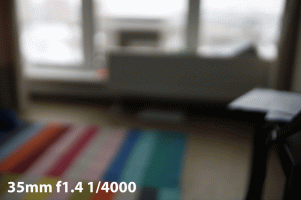

We all know, that EFCS ( Electronic first curtain shutter ) is great for reducing shutter shake, but affects bokeh at high shutter speeds.
Below is my example of how it looks like. Pretty big hit on bokeh. So You're getting roghly f2.0 blur out of f1.4 lens at 1/4000. And at iso 100 and f1.4 - most of daytime shots outside would require 1/3200-1/4000.
Even worse if you're lucky and have 1.2 lens - you'll be stuck with 1/4000
I admit - that is the price we pay for the luxury of EFCS, and mirrorles, but EVERY Full Frame mirrorless out there EXCEPT for Rp allows some form of workaround. For example - full electronic shutter does not affect bokeh in any way.
But the Rp only allows full e-shutter in scene modes + in focus stacking mode. So if you're shooting AV - there is no way to save your bokeh.
This is especially sad, because Canon has that great new RF glass with f1.2
Canon, plaease enable full electronic shutter in firmware update for Rp. We know it's technically there - just make it available in PASM modes.
I'm not asking for 1/8000. I know Rp is not a pro body by any means. And frankly 1/4000 is a huge limitation in using f1.2-f1.4 glass outdoors. But please allow 1/4000 with full electronic shutter.

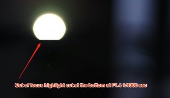

This takes splitting hairs to a new level
Well, the effect is fairly obvious. If the example is post #1 is not bad enough - here is what it looks like when there are sharp highlights out of focus.
Would you still consider that acceptable for a FF camera? Even at $999
That honestly looks less offensive than the mirror box cutting off the bokeh balls, which is a phenomenon present on all DSLR, even the ones above 999.
The annoying thing here is clearly that the camera has an option to avoid such defects but doesn't allow the user to make use of it in their preferred modes. A pure software thing, and yes, it is differentiation - but in an annoying way.
