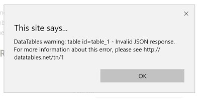

Hi, just to say that this brings up a JSON error... in both Firefox and MS Edge Win10x64
