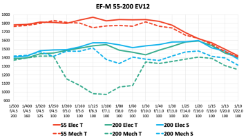

Possibly the best of the mid-range EF-M zooms, unless you need the additional reach. Some shutter shock at the tele end.
The EF-M 15-45 is poor at the tele end and suffers from shutter shock.
The EF-M 18-150 is poor at the tele end and suffers some serious shutter shock.
The EF-M 55-200 is poor at the tele end and can suffer significant shutter shock. Thought the performance isn't that much worse than the 18-150 at 150. The Systematic tripod reduced the shutter shock.
