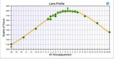

Well, unfortunately I know all too well about what can and goes wrong with camera/lenses, and I know all there is to know about moving individual af points to match a lens. But this is not the case here. And I have done the same tests with all my cameras for a decade and this is a first for me, this issue. I don't want to sound like a jerk, but I know how to test this and I know how to focus on a subject. I have 3000 shots on the 1dx2 90% testing with FoCal and in real life.
I actually get sharper images with normal phase af than Live View focus, that I don't know an answer for at all. Manual focus and phase gives me the exact same results, but not sharp as it was on the 1dx. That's all I know. I don't thing anything is wrong with MY camera. I can't be that unlucky :P
Here's one of the runs I did with the manual calibrations in FoCal, thanks for the tip Neuro, and it's way better than the automatic calibrations. I can't remember how high it went on the 1dx, but I thought it was around 1900 or something..

Put up a test chart (2 dimensional and perpendicular to camera) in reasonably bright light and shoot that. Put the camera on a tripod, use mirror up and a remote release. Take some shots using AF and some manually focussed, all with the lens wide open. Should take no more than half an hour to have answer, that's what I do when I have an issue, if I'm not happy after that, back it goes.....oh, and switch off IS.
Well, that and FoCal is where the 3000 shots and frustration comes from. You can see one of graphs just above here ;)
