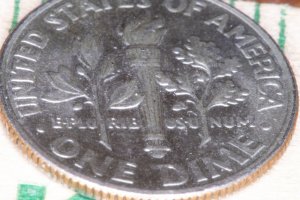

With 68mm of extension tubes, the 100mm macro lens focused as close as possible appears to project 1/2 inch of image on to 1.035 inches on the sensor. I'm not sure of notation. Is that a 1:0.483 magnification? Or anyway, the sensor image is 2.07 times the size of the object.
At that magnification, a US dime looks like this on a full frame:

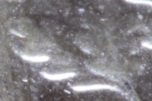

And a 100% crop of that shot looks like this:
Both shots were taken at f/22 on the lens, so you can calculate the effective aperture with the tubes. By a quick rule of thumb, you would get something like f/70 in this situation, hence the exposure time of 8 seconds even with the ring light set on high.
With respect to the coin, is there some reason it doesn't look very sharp? I know depth of field is a challenge (and the coin does look about the same regardless of distance from the lens), but your 100% crop simply doesn't look nearly as sharp as it could be. (I say this having photographed MANY coins.)
That aside, you've certainly proved you're at better than 1:1 with that setup!

Again, I’m no expert, but could the lack of sharpness be from diffraction, I get using f/22 to capture the full height of the coin, but a shot from overhead giving a flat plain would allow A much larger aperture. I suppose the overhead shot might reduce contrast slightly?
Cheers, Graham.

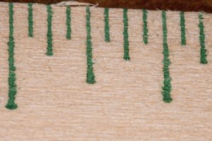

I’ll go back and look at the whole original. I wondered about that myself. It could be a combination of things. The coin itself is worn to begin with. I purposely shot the coin at an angle, but maybe not with good reason. Maybe there is a spot in the picture that is better in focus. I don‘t know how the tubes affect diffraction. Does the result reflect the diffraction of f/70ish instead of f/22? I’ve made pictures with the lens by itself at f/22 that were sharper than I would have expected given what I have read about diffraction. Even f/32 has shown only slight softening beyond f/22 that was not unattractive in effect, maybe a bit less clinical looking. Diffraction is a likely suspect, especially if I don’t find a sharper area on the shot. The detail in the wood of the ruler looks sharper than the coin to me. I’ll see what settings I used for that shot.
I didn’t use a delay, as I would with an important shot. So there my have been some vibration. And there were a couple shots after I unplugged the remote release. Maybe I will try again using a wireless remote and a 2 second delay.
