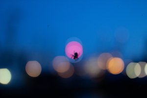

I believe there is nothing wrong with your setup, if that is what you are asking.
As objects get close enough to the lens and obstruct a bokeh ball, their shape becomes part of the bokeh ball. It is what allows you to use a cardboard cutout to shape your bokeh balls like stars or hearts for example. I think the combination of small lights (good point source approximations) and the single color of LEDs makes this more noticeable. I have a shot with a similar effect done with my 600D and Sigma 35 mm 1.4 Art.
Your doll seems to 'cast a shadow' onto your bokeh balls, giving it this weird effect.
The spider seems to have the same effect. Thanks. I think this shows the effect is not strange after all, but common in this situation.
My lens was close to MFD, but not quite. The tree was about seven or eight feet behind the subject. (We were going to take the tree down yesterday morning, but when I saw the images from the night before I wanted to hold off and try again with different lenses and bodies last night.)
I was definitely relieved to see the same results on different bodies and lenses!
I wonder if other light sources behave differently. Incandescent? Hmmm. It is not pretty!
