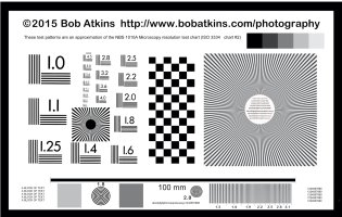

If you want to look for motion blur, then use a proper target with graduated vertical and horizontal lines, concentric circles, and stars, like this one from Bob Atkins. That way, you will readily detect motion or shutter slap by differential resolution in the horizontal and vertical directions. I test my lenses hand held at different shutter speeds to know which ranges I can use without motion or mechanical blurring.

If you want to look for motion blur, then use a proper target with graduated vertical and horizontal lines, concentric circles, and stars, like this one from Bob Atkins. That way, you will readily detect motion or shutter slap by differential resolution in the horizontal and vertical directions. I test my lenses hand held at different shutter speeds to know which ranges I can use without motion or mechanical blurring...
Thank you, Alan. I'm printing five of these on 4x6 glossy now to glue to a foam board. I'm sure this won't be the last time I want to test lenses, IBIS, AF.

I decided to go with a block of nine 4x6 prints for a test target, all permanently glued to a foam board. Seems like too many, right? But this way I've got all my edges covered for other types of tests in the future! Right now a few prints are drying, and then I'll glue them in place, and then, hopefully by the weekend have some results to share.
