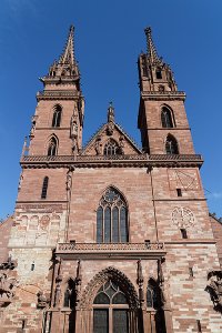

It's not the landscapes, it's the, "...c) Old castles and buildings," that the OP mentions. Below are two shots of the Basel Münster, in both cases the shot was taken from as far back in the plaza as I could stand – my back was literally against the wall of the building across the plaza. The first was during a daytime walkaround with the ultraportable EOS M and M18-55 @ 18mm (29mm FF equivalent FoV). The second was with the 1D X and TS-E 17mm at the end of the day before blue hour, so I 'cheated' with a 10-stop ND in front of the lens, for a ~3 minute exposure (which offered the benefit of blurring out the pedestrians and cyclists that passed through the shot).
In Switzerland and throughout Europe there are many beautiful buildings with very little space around them...so for architecture shooting, I consider an ultrawide extremely useful, particularly the TS-E 17 so the keystoning (very evident in the first shot) can be corrected.
