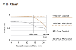

<p><strong>1.  Even when used wide open at F1.8 aperture, provides outstanding image quality with maximum aberration compensation, thanks to optimal use of sophisticated glass materials and highly advanced optical design</strong>
SP 35mm F1.8 Di VC USD (Model F012) is a 10-element, 9-group construction, utilizing two molded glass aspherical elements, one LD (Low Dispersion) and one XLD (eXtra Low Dispersion) element.</p>
<p>Two of the aspherical elements effectively correct the field curvature to ensure planarity of the image plane, while efficiently compensating for spherical and comatic aberrations to achieve superb uniformity across the field with high-fidelity point spread reproducibility. Outstanding resolution is rendered from corner to corner and the sagittal comatic flare (a type of aberration that a point image at corners induces a comet tail-like blur), which tends to become prominently noticeable in night scenes, is corrected.</p>
<p>The LD and the higher grade XLD glass elements optimally compensate for chromatic aberrations, which tend to become particularly prominent in fast-aperture lenses in general, and deliver crystal clear images without any residual color fringe.</p>

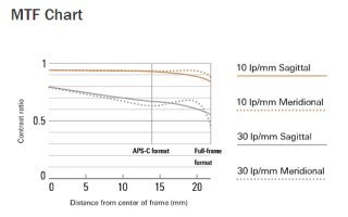

SP 45mm F1.8 Di VC USD (Model F013) is a 10-element, 8-group construction, utilizing two molded glass aspherical elements and one LD (Low Dispersion) element.</p>
<p>Two of the aspherical elements effectively correct the field curvature to ensure planarity of the image plane, while efficiently compensating for spherical and comatic aberrations to achieve superb uniformity across the field with high-fidelity point spread reproducibility. Outstanding resolution is rendered from corner to corner and the sagittal comatic flare (a type of aberration that a point image at corners induces a comet tail-like blur), which tends to become prominently noticeable in night scenes, is thoroughly corrected.</p>
<p>The LD glass element optimally compensates for chromatic aberrations, which tend to become particularly prominent in fast-aperture lenses in general, and delivers crystal clear images without any residual color fringe.</p>

Hi All....
As I did the other day for the Canon 35mm f/1.4 L, I am providing my Canon Rumors friends the MTFs (happy to help!)
Note- I am providing the MTFs in this order:
Tamron SP 35mm F1.8 Di VC USD
Tamron SP 45mm F1.8 Di VC USD
Wow!!! Pretty impressive imho. Your thoughts of these MTFs??
For what it's worth, I'm more interested in the 45mm than the 35mm... I quite often use the 45 - 55mm focal length on my Canon 7D where a bright prime comes in handy... VC is icing on the cake! If USD proves to be accurate, fast and consistent... well... I may be 'sold' on my first Tamron!
Paul 8)

pj1974 said:
Hi All....
Paul 8)
That 45 looks pretty nice on the MTF. The 35 is more reminiscent of the old Canon 35 f/2 non IS albeit with an improved optical quality but it drop offs once outside APS-C territory just like Canon's did. Made it a great lens for crop cameras other than the AF performance. I think this one will be similar.
