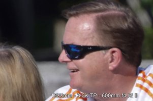

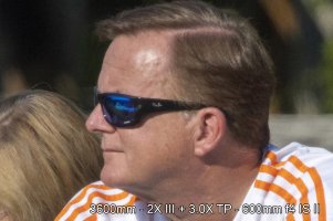

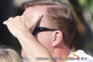

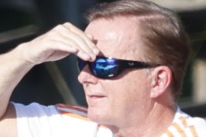

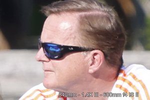

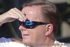

Go easy on me, I did this for fun. Getting into bird photography, I acquired a 600mm F4 IS II and a 1.4X and 2.0X vIII Converters. I really enjoy the set. Of course I saw the Fro Knows Photo YouTube video saying Teleconverters are bad (mostly). So I decided to run some tests. But I also came across the TellPlus 3.0X converter on ebay and figured hey why not try it.

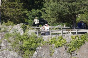

Location: So at Great Falls National Park there You can view the Falls from The East or West river banks. It's humorous because you sort of look across at the people on the others side. They are approximately 550' away. And there was his blond guy who looked a little like me. And he was wearing Sunglasses with a RayBan Logo.
Shooting: Shooting with a Canon R5 and Canon EF to RF converter. Manual with Auto ISO, f4 (or widest Aperture) and 1/2000. All Focusing was AF. I shot about 10 photos of each combo and picked the sharpest.
Post Processing: I cropped the photo to just his head, and then uprezzed the photo so all were the same 2000 pixels wide.
The 600mm (no converter) shot looks unusually soft for what would have been a basically stationary subject? Some issue with the AF?
The 600mm shot above is heavily cropped and then blown up 600% to match the 6X photo. Before being blown up its very sharp but the man is still 550 feet away. If I could have walked to 1/6 the distance, 92 feet away, and shot at 600mm that photo would be better than all of these, but that was not the test I was running.
I'll attach it here, but I can't attach it at full rez because it's 8000 pixels wide.
Here is a cut out at original resolution.
It looks like the 1800mm shot has a touch of motion blur in it. It can be seen in several areas. I’m surprised the 3600mm combo didn’t cause the same issue.
