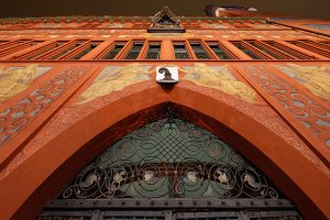

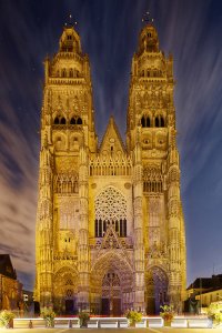

Thanks for that. 9:29 lol you need to get out more, well spotted eagle eye. Someone mentioned you could use the 1.4 extender with the 17 if 17 was too wide.
Yes, the TS-E lenses are compatible with Canon's EF extenders. They won't be reported in the EXIF, though.
As for 17mm being too wide, I often find it necessary...but my architectural exteriors are generally of fairly large structures.

"Rathaus Basel"
EOS 1D X, TS-E 17mm f/4L, 30 s, f/11, ISO 100
"Cathédrale Saint-Gatien de Tours"
EOS 1D X, TS-E 17mm f/4L, 25s, f/8, ISO 800

"Rathaus Basel"
I often use the 24mm, but quite often, it isn't wide enough, as you demonstrated with the Saint-Gatien picture. And stitching takes time.

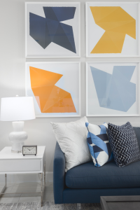

I’ve been considering the TS-E17 for a while now. I never considered it with a TC. After reading various reviews, the opinion of the 17 varies from “sharpest lens ever!” To “ fairly soft in corners once tilted”. I’d like your thoughts, and how IQ is affected with the 1.4TC. Of course, any other observations are welcome.
Well it's both, unshifted it is very sharp, as it is with the 1.4. and 2x TC's, plenty sharp enough for commercial architectural work. However when shifted, particularly when shifted a long way, the corners are not very good, but the truth is if you need shifted 17mm what choices do you have? Personally I find whens shifted modestly with a 1.4 TC the IQ. is easily up to commercial architectural image standards.
This is a shifted TS-E 17mm + 1.4TC image.
Thanks for the info and the photo (I still don’t think to type the word “image”). I like the options the 17 + the 1.4 TC give.
