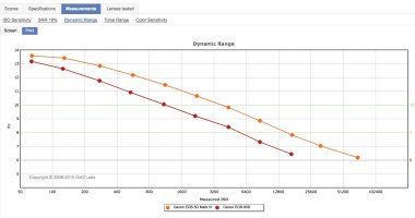

5DMk4 same dynamic range as 80D? That's not what I have seen from lab testing by Claff and DxOmark.
If you read my entire post instead of taking just one sentence out of it, the DXOMark numbers prove my point precisely. I said that in perfect lighting situations, where you can shoot at ISO 100 they have nearly identical performance. I also said that as ISO increased, the 5D4's definitely had an edge in image quality, if I could get close enough to the subject -- and that means better pictures of birds in flight if there's filtered light, because in such situations, to maintain high shutter speeds with crappy aperture, it's necessary to up the ISO to as high as 400.
Yes, the 5D4 scores very slightly higher dynamic range at 100. But it's a very small number, and if you weigh it against the number of megapixels that you lose -- I'll take the megapixels, thank you, because I can improve dynamic range in post, whereas if I don't have enough pixels of the subject, the photo is worthless.
My point was never that an 80D is a better camera body than a 5D4. It was that the 80D is a different tool, and in certain, specific circumstances -- specifically, when lighting isn't an issue, and you're at the limit of your focal range of the crop area and you'd be discarding the rest of the frame, or more, anyhow -- it can yield a superior (or usable) photograph.
Edit: it's also worth mentioning that when using imperfect optics -- which is the case with many at long telephoto lengths, because not a lot of amateurs can afford professional primes -- APS-C means that you're only using the center 63% of the lens, which will be the part of the lens with the least problems. That means you're squeezing 24 megapixels out of the center 63% of glass, rather than a 28 megapixels out of 100% of the glass.
