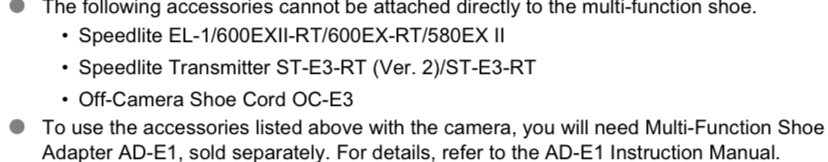

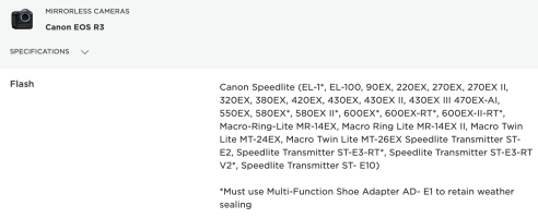

I think my understanding is consistent with the R3 specs. This is from Canon Europe:
The current current sealed hotshoe products are listed as compatible, with a footnote indicating the adapter is required to retain weather sealing.

You're jeopardizing your speedlite's locking foot every time you CRANK that on your camera. With my ST-E3-RT, I could only get half way before the lock stopped cold. If I pushed super hard, I could get it to lock. Why would I do that when it destroys the weather sealing anyway?

I have four 600EX-RT flashes and none need to be 'cranked' onto my R3, I just push the locking lever over firmly and they lock down. They mount in exactly the same way they did on my 1D X, with the same force required. Perhaps your ST-E3 was damaged to begin with?
Regardless, Canon states they are compatible so please stop spreading your misinformation.
