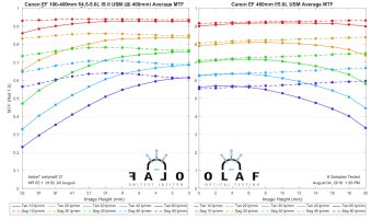

Here are the charts we are looking at, put side by side, with the left hand one flipped horizontally in the manner of Lensrentals. Where it counts for a telephoto lens, the large inner circle, the 100-400mm II is better at the edge sharpness MTFs (10 lp/mm), and for resolution at more lp/mm, is streets ahead. Saying the prime is more balanced optically is like saying someone has a balanced personality because they have a chip on each shoulder.
Charts are produced by Lensrentals.

Ah, I see what's going on now.
I'm talking about "corner sharpness" and "IQ at the edge of the frame".
The 100-400MkII is sharper at the center of the frame, but on the TDP samples it's a very slight improvement, and overall contrast is better on the Prime. If you were going to shoot Full Frame I'm confident most people would prefer the Prime.
http://www.the-digital-picture.com/Reviews/ISO-12233-Sample-Crops.aspx?Lens=972&Camera=453&Sample=0&FLI=4&API=0&LensComp=278&CameraComp=453&SampleComp=0&FLIComp=0&APIComp=0
It's kind of a shame that as soon as you Zoom to 300mm the IQ is practically perfect, I still wish they would just make these things 200-400 and actually give it the best image possible at the long end.
