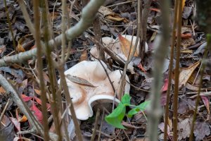

very nice shots, i just need to find good setup for lighting because im not too good with DIY and i may buy it soon if Canon doesnt annonce the 24mm before. It seems really niche haha, i see only one used for sale in Canada on 2-3 sites i looked.
You can post the mushroom pic yes. I had some on my lawn really similar as these, didnt find what it was exactly.

very cool , the ones i found might not be same thing. Mines have big thick stipes and yours have striate margins. The caps on your first photo looked alike.
I wish there was a way to know when an image is focus stacked or not when im looking at a gallery. Some shots im not sure with this lens haha.
this old snapshot was with a Canon Rebel XSI and EF-S 18-55mm f/3.5-5.6 IS
If the subjekt has more DOF than the background, is a hint.
If there are some glitches of the rendering you could be shure. Look at the edges of the cap in my picture! I should have done more editing.:cautious:
Sometimes you can also see a halo caused by the software.
