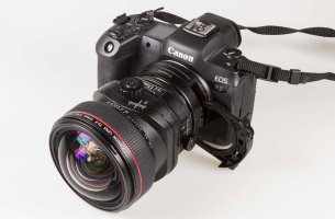

Yay, an R5 and lenses turn up for testing
A welcome parcel from Canon this morning, with this lot
RF 24-70mm F2.8 L IS USM TS-E 50mm f/2.8L MACRO EF-EOS R Adapter with Drop-in Circular Polarizing Filter EOS R5 RF 15-35mm F2.8 L IS USM RF 70-200mm F2.8 L IS USM
I've unfortunately only got it a couple of weeks, but want to test it for stills use, especially with tilt/shift lenses (17/24/50)

One benefit of the R5 - I can use the filter version of the ef-rf adapter. It works just fine with the TS-E17 and polariser. OK you get all the issues you'd expect of a polariser with something that wide, but at least I can use it hnd held ;-) I'll post a vid/article about just this tomorrow if I get a chance
Yes that was a big interest point for me too, but I have the Fotodiox Wonderpana and CPL for the TS-E17 which really is the only filter I want for it, and even though I have it I rarely use it...

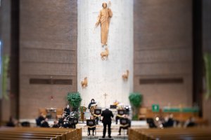

Well the live video feed meant I didn't have as much freedom of movement as I'd hoped. I did play with the TS-E 50 a bit but I'm not sure it is any kind of advert for the lens.
Here's one missed shot, but you can see what I was aiming for, a line of focus down the center of the image, I knew where I had gone wrong. I was actually thinking of Keith when I took it as I had done another shot with the plane of focus the other way first but his voice was ringing in my ear 'make it a toy', so I tried and failed....
One thing I will say is the focusing screens on OVF's do not show anything like the dof you actually get, they are far too dim and show a much smaller aperture so you think you are getting much more in focus.

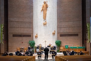

Here is the previous shot with the plane of focus horizontal @ f2.8.
I can see what you were aiming for on the first picture. When I first looked at the image on my phone which made it very small I could see the focus running up the middle of the orchestra and the column with the figure of Christ on it. So you've turned the lens to use the tilt as swing ? I'd like to see the full file of the second image as you've got the plane of focus throughout that plane at f/2.8.
Regarding manual focus I feel your pain in trying to focus with "modern Brite" screens. To be honest though, I have found focus peaking in the M5's EVF to be no better than an 'S' screen in a dslr, maybe the 1DXII takes them ? For me at any rate, the only way to nail shallow DOF focus with a manual lens is the old fashioned way of magnifying the image, but now instead of having to put a loop on the glass focusing screen of a LF camera we can do it electronically ! In a dynamic situation this is very clunky of course and I find it's awkward through the viewfinder, at least on the M5, and easier on the back screen, ergo mirrorless doesn't help me as much with manual focus as I thought it would.
