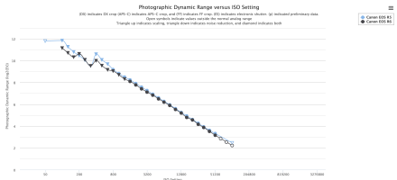

This has been discussed and explained many times here: when it comes to low light performance, low density megapixel sensors do not necessarily have better low light performance than high density sensors when the image is viewed at the same size for both. Here, for example is the dynamic range vs iso (which is highly correlated with noise) for the R5 vs R6 https://www.photonstophotos.net/Charts/PDR.htm#Canon EOS R5,Canon EOS R6
