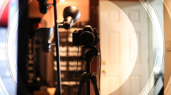

That said, there appears to be an issue with the Canon EOS-1D X Mark II and Sigma lenses when paired together, you see in the image above the type of visual defect we're talking about. It appears the Canon EOS-1D X Mark II is attempting to correct vignetting and other characteristics of the Sigma lens attached. As you can see, it's not doing a very good job.
To correct this issue do the following.
- Navigate to red menu 1 and locate Lens abberation correction
- Turn Peripheral illum corr to OFF
This should solve your issues so you can get back to enjoying your EOS-1D X Mark II and excellent Sigma lenses.
