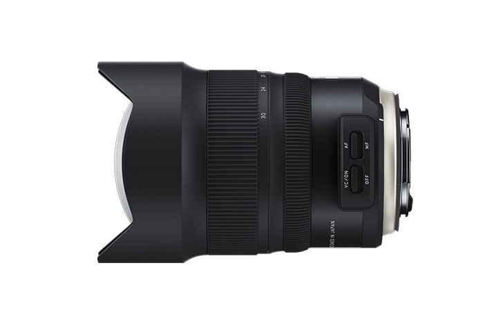

    We would like to announce that we have clarified compatibility in general operations(*1) of following Tamron Di & Di II lenses on Canon EOS R, which was newly released on October 25, 2018, with Canon Mount Adapter(*2).
    1. Compatible models in general operations(*3)
      SP 15-30mm F/2.8 Di VC USD G2 (Model A041) for Canon
      SP 24-70mm F/2.8 Di VC USD G2 (Model A032) for Canon
      SP 70-200mm F/2.8 Di VC USD G2 (Model A025) for Canon
      SP 35mm F/1.8 Di VC USD (Model F012) for Canon
      SP 45mm F/1.8 Di VC USD (Model F013) for Canon
      SP 85mm F/1.8 Di VC USD (Model F016) for Canon
      SP 90mm F/2.8 Di MACRO 1:1 VC USD (Model F017) for Canon
      17-35mm F/2.8-4 Di OSD (Model A037) for Canon
      70-210mm F/4 Di VC USD (Model A034) for Canon
      (*1) Defined to work on existing DSLR cameras
      (*2) Canon “Mount Adapter EF-EOS R”
      (*3) With the latest version of lens firmware
      About other Tamron models, we will make a further announcement of the compatibility at our support web page once the operation tests are completed.
      Thank you for your patience and understanding in this matter.
