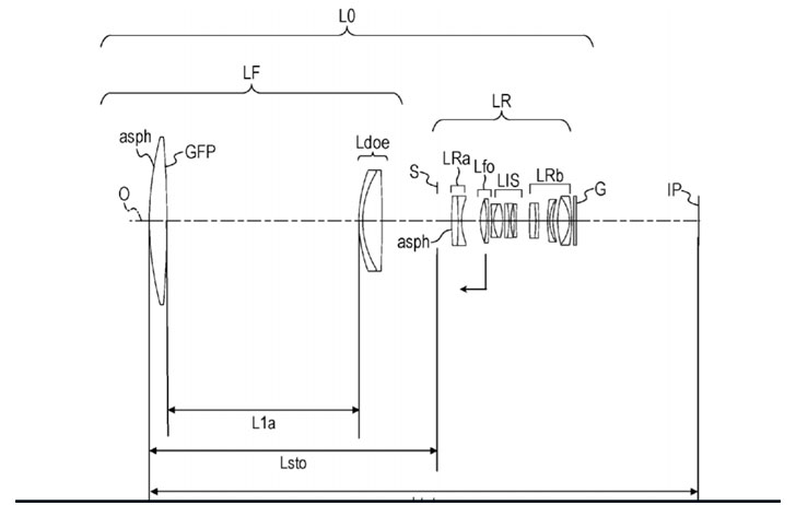

Here is another in a long line of diffractive optics patents we've seen from Canon over the last couple of years. Since the Canon EXPO in 2015, we've all been wondering where the EF 600mm f/4 DO IS lens is, a lens we don't think is ever coming at this point. A lot has changed over the last 3 years, and we expect any new DO super telephoto lens to be for Canon's new RF mount.
This latest USPTO patent showcases both a 500mm and 600mm optical formula. As Canon News points out, this patent shows Canon moving the lens elements closer to the camera body to improve balance. This is the same sort of design we saw in the brand new EF 400mm f/2.8L IS III and EF 600mm f/4L IS III lenses.
Example 1:
- Focal Length: 487.49mm
- F-Number: 4.12
- Half angle of view: 2.54º
- Image height: 21.64mm
- Total lens length: 409.74mm
- Backfocus: 98.42mm
Example 2:
- Focal Length: 584.99mm
- F-Number: 4.12
- Half angle of view: 2.12º
- Total lens length: 474.74mm
- Backfocus: 109.42mm

Why should it? RF mount is perfect for lenses with a short backfocus, like lenses with a focal length of up to ~100 mm. I don't see a benefit of the RF mount for longer lenses: (super) telephoto lenses have a huge backfocus anyway (as is also shown in this patent), that makes them perfectly suited for the EF mount. I think it makes just more sense to make those lenses physically shorter EF lenses an use an adapter for RF mounts than make them physically longer (with an empty tube at the back) and make them RF-natively. At most, Canon could release EF- and RF- supertelephotolenses of the very same design just a different end-barrel (plus offer a mount conversion service).
The only advantage I can imagine could come from the (slightly) larger mount diameter of the RF mount, but I have no idea whether that makes designing RF-supertelephoto lenses easier than EF-supertelephoto lenses. But it could be... But for the back focus: no!
So apart from avoiding the use of an adapter there should be no mechanical/optical advantage to making an RF supertele lens over an EF one.
The note from DanCarr about the sizes is interesting. According to the Canon Website the current 600mm III is 448mm long and the post above suggests the DO version would be 474mm long. Am I missing something about the way these are measured?
The increase could be explained in part by the addition of 24mm empty tube to an RF lens. But if a DO Version actually becomes bigger than its regular counterpart, I imagine the weight the reduction would have to be really significant to still sell well.

So, really no reason I see to make large backfocus lenses with a native RF mount...
No technical/mechanical reason you mean. Plenty of business and marketing reasons to make it an RF lens.
I checked, and saw that. Unless the length would include the hood, I don't see the advantage. The 500 f/4 II IS is an awesome lens. Lightening and/or reducing the size is what it needs. But if they do to it what they did to the 400 and 600, then I'm not sure that there's a place for DO.
They could easily make any of the super-telephoto lenses in either EF or R mount as the situation demands. The backfocus distance is much larger than the spacing between the lens and sensor on either mount.
The big differences would be no adapter needed for the R mount, and the additional communications that R offers between the lens and the camera. Optically, they could essentially be identical.
