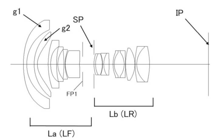

Patent: Canon EF 10mm f/2.8L USM
A patent application showing the optical formula for an EF 10mm f/2.8 prime lens has been filed in Japan.
Japan Patent Application 2018-233223:
  • Focal length: 10.30mm
  • F number: 2.88
  • The half angle of view: 64.54°
  • Image height: 21.64mm
  • Lens length: 124.58mm
  • Back focus: 38.00mm
It looks like this patent may have been a part of the EF 11-24mm f/4L USM development.
It's more than that, it is the patent of the optical formula of the EF 11-24mm f/4L USM.
Example 1 of the patent:
183497
Canon EF 11-24mm f/4L USM:
183496
You really don't under stand what a patent is do you....patents always come first. Production never comes before a patent.
Ahem!... See above.
