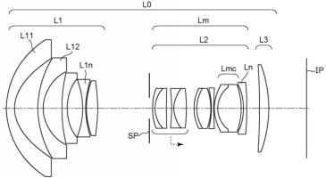

Our earlier report of a new ultra wide angle RF L lens coming in the first half of 2023 gets a related patent application for a similar optical formula, along with others.
asobinet found and first reported on this patent.
Canon RF 10-20mm f/4
  • Focal length: 10.30mm – 19.40mm
  • F-number: 4.12
  • Half angle of view: 62.03° – 48.12°
  • Image Height: 19.40mm – 21.64mm
  • Length: 129.14mm – 132.69mm
  • Back Focus: 15.09mm
Canon RF 9-18mm f/4
  • Focal length: 9.27mm-17.46mm
  • F-number: 4.12
  • Half angle of view: 64.34° – 51.10°
  • Height: 19.30mm – 21.64mm
  • Length: 124.52mm – 125.00mm
  • Back Focus: 15.37mm
Canon RF 11-24mm f/4L USM
  • Focal length: 11.33mm-23.28mm
  • F-number: 4.12
  • Half angle of view: 59.58° – 42.90°
  • Length: 130.00mm – 131.90mm
  • Back Focus: 16.34mm

  1. Interesting. Comparing the block diagrams of the EF 11-24/4L vs the 11-24 in the patent, they are very different. It looks like a completely new design, with full advantage being taken of the very short back focus.
    Unfortunately the EF 11-24 was very expensive when launched, and the RF lens will no doubt follow in its footsteps and then some.
  2. To me, f/5.6 would be awesome if that allowed for a front filter thread.
    Would the RF mount specs and f/5.6 slow enough to allow for a front filter on such a zoom?
  3. To me, f/5.6 would be awesome if that allowed for a front filter thread.
    Looking at the bulbous front elements in the patent examples, I doubt it.

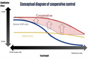

  4. ...how effective is the IBIS when the R5 is mated to the adapted EF 11-24?
    I presume that none of the wide angle lenses included in the patent incorporate (in-lens) IS...
    I have found the IS feature present in the EF-M 11-22 to be invaluable for a wide variety of travel photography situations...and in general, this stabilized EF-M lens has (for me) replaced the (non IS) EF 17-40mm f4 for many uses.
    So I have long wondered about the IBIS capabilities of the R5, particularly for wide-angled non-stabilized EF (and now for the upcoming RF) lenses.
  5. ...how effective is the IBIS when the R5 is mated to the adapted EF 11-24?
    I find the IBIS on my R3 to be very effective with my EF 11-24/4. That's what one would expect given that body stabilization is more effective at shorter focal lengths while lens stabilization is more effective at longer focal lengths.
  6. The big question is...is it going to have drop in filters? Currently the Ef mount version has a huge advantage because there are ef-R mount adapters that allow a single drop in filter (ND or polariser). This is a lot more preferable then messing with gels on the rear mount slider.
  7. The big question is...is it going to have drop in filters? Currently the Ef mount version has a huge advantage because there are ef-R mount adapters that allow a single drop in filter (ND or polariser). This is a lot more preferable then messing with gels on the rear mount slider.
    No room for that in the designs.
