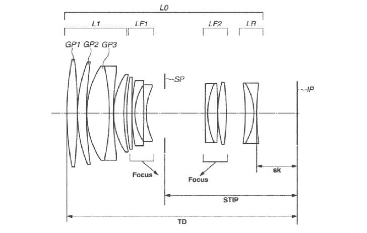

Northlight has uncovered a USPTO patent dealing with various prime lenses for the RF mount with a max aperture of f/1.8
Canon RF 105mm f/1.8
- Focal Length: 105.00mm
- F-number: 1.85
- Half Angle of View: 11.64°
- Image Height: 21.63mm
- Overall Lens Length: 145.01mm
Canon RF 130mm f/1.8
- Focal Length: 131.00mm
- F-number: 1.85
- Half Angle of View: 9.38°
- Overall Lens Length: 155.01mm
- BF: 27.26mm
Canon RF 150mm f/1.8
- Focal Length: 150.00mm
- F-number: 1.85
- Half Angle of View: 8.21°
- Overall Lens Length: 164.98mm

The 150 mm could even be the first "triple-nano" design:
Except they couple the groups mechanically.
Based on the fig. 3 design, you're right in that they could implement a triple nano focusing system. But why do you say they couple the groups mechanically? I only see movement in the 3 different lens groups that have the "Focus" mentioned, as the other elements don't move. So they could have 3 independantly moving nano groups. The main problem I could see is that 2 of those moving groups are almost touching each other so it may be hard to pack the moving rails and hardware so close together between them. On second thought, they could use a single set of rails for the 2 close focus groups while moving them separately with 2 independent nano motors.
But it they did do a "triple nano" design, imagine the better focusing ability they'd have, not to mention the new beautiful advertising videos they could use to sell them? Who knows, maybe a triple nano focusing would give them more flexibility to increase the close focusing ability, and thus increase the maximum magnification? I'd LOVE to see lenses like this with a 0.5X max magnification at high IQ and wide apertures - can you imagine how much beautiful background blur that would give you? - Wow! :oops:
I was thinking about helicoids driven by a USM ring-motor moving the two groups in the back, exactly because they are very close together. But they could also share rails as you said and have the nano-USM drivers at opposite sides of the optics. That might extend the parameter range of the lens.
Anyways, this is just a patent application, if at all this lens will be realized, it will likely have a different design.
Still, could be a very interesting lens!
