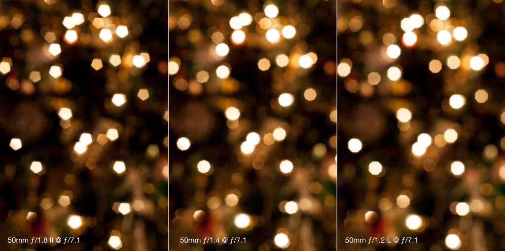

Having owned the 50mm f/1.4 lens for a few years, I had high expectations for the red-ringed 1.2. Now, I’m not sure what I expected, since f/1.2 is notoriously shallow and my experience with any prime wide-open hasn’t lent itself to the sharpest results (caveat emptor: experiences may vary, and I’m not counting the incredible 200mm f/2 L IS in that statement). So I was a bit disappointed when my f/1.2 images were pretty soft, though they still retained a good amount of colour and contrast, important factors in a quality lens ñ and quickly sharpened when stopped down to f/1.8. The sweet spot of most lenses is a good three clicks to the right (for us Canon users) which makes sense; I use my 1.4 at f/2.0 mostly. The 8 rounded aperture blades help maintain this wonderfully blurred out background. Bokeh is something best seen, so here are some comparisons below:
I made some adjustments to these crops to boost the contrast. You can clearly see the pentagonal shape of the Bokeh produced by the 1.8, but hardly any difference in the shape between the 1.4 and 1.2 – wide open, these results become less obvious. This is also not a commentary on the overall quality of the Bokeh, which is more of a personal feel, but this type of test was my original reason for avoiding the 1.8.
