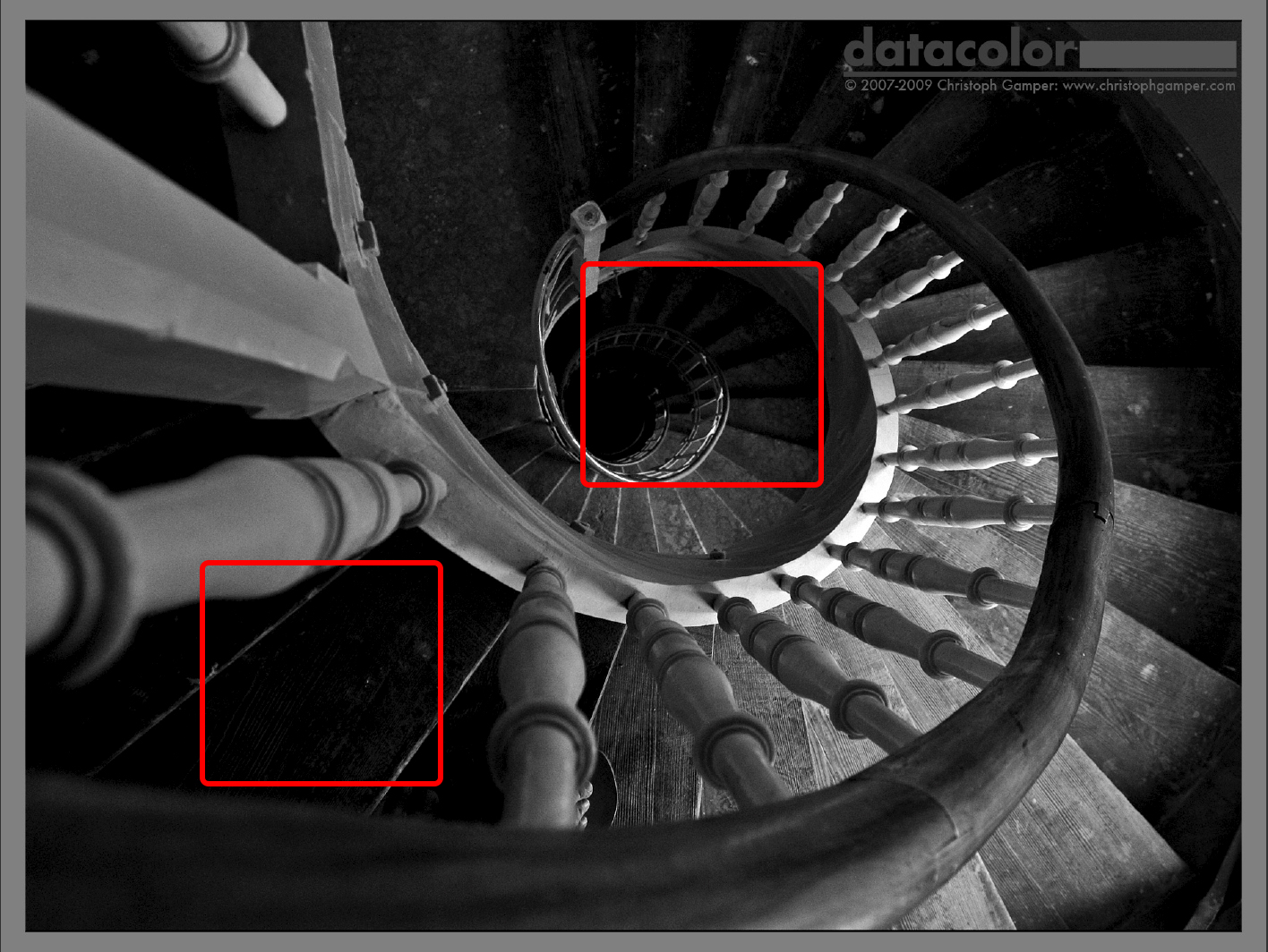

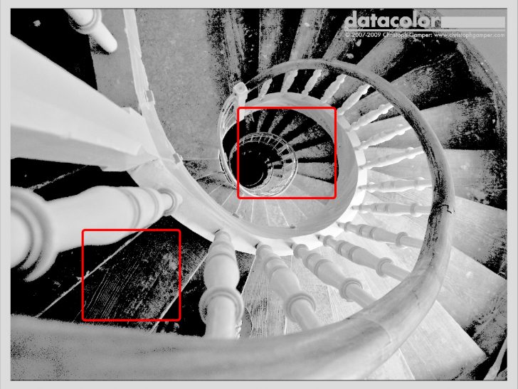

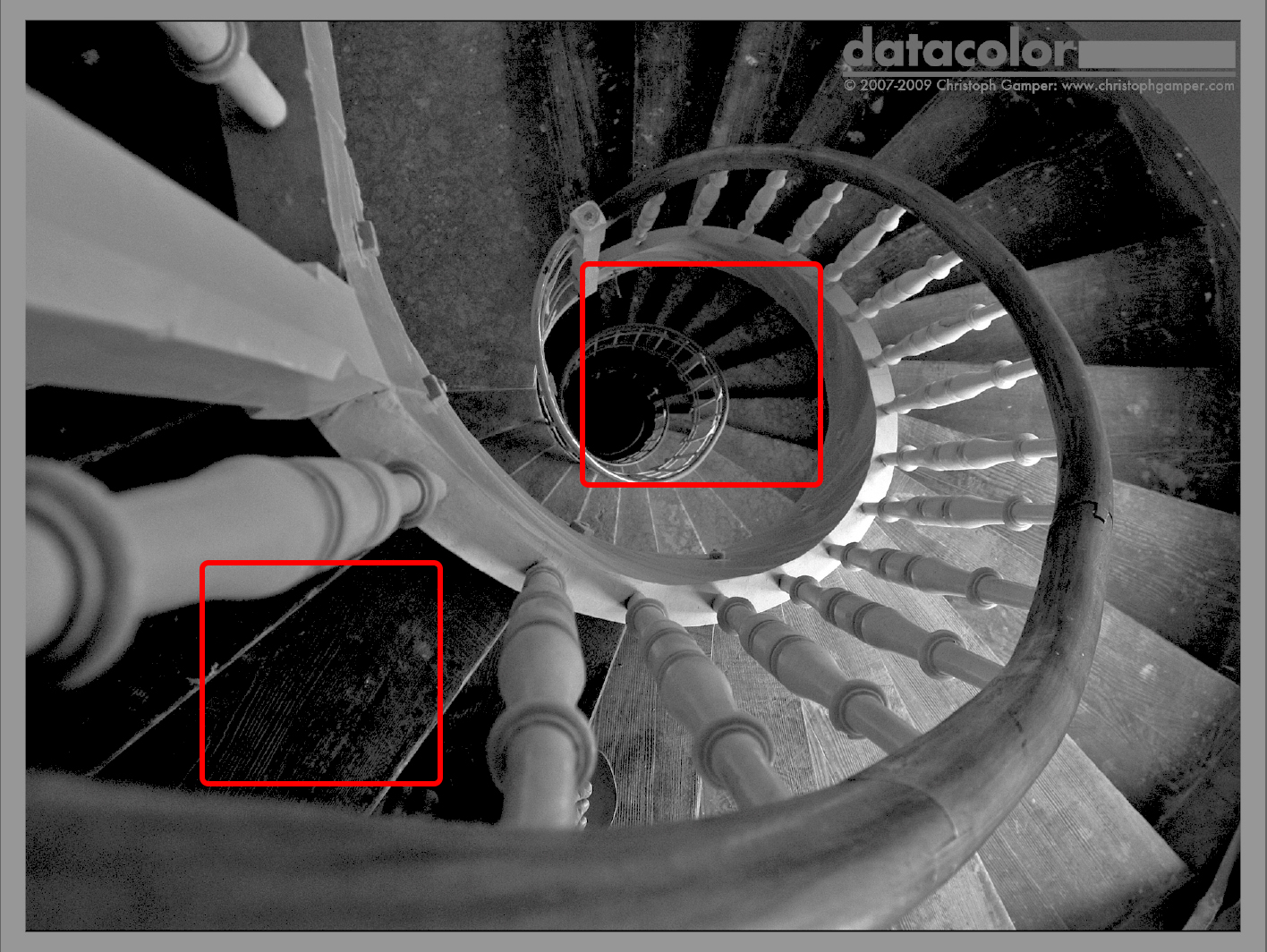

If your print seems too dark, this is an issue with the brightness, or luminance, of your display. Controlling the luminance of your display and the brightness of your working environment is essential to achieve the best consistency from screen to print. It’s important to note that dark prints can also make it seem like color is incorrect in the final print.
For a well calibrated display for photo editing and printing, you will need to adjust the luminance to a specified range of 100-120 cd/m2. The Spyder5PRO and Spyder5ELITE can make these corrections. At first, this luminance setting can seem rather dim but with the proper lighting in your work area it will seem natural.
The lighting in your room should be fairly subdued for 100-120 cd/m2 to be a comfortable luminance setting. A good rule of thumb is your monitor should be the brightest light source in your room. A monitor hood is advised if you can’t adjust the lighting in your workspace.
A luminance of 100-120 cd/m2 is the recommended range because it offers a good balance between what you see on a display and the image in print. Going above 120 cd/m2 will generally artificially brighten your image. If your image is artificially brightened, it will make it more difficult to accurately evaluate the exposure of your image in print. Left uncorrected, the result will be a print that appears too dark.
