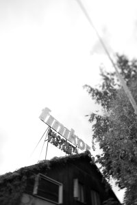

I would not say that the tilt is ineffective on wide angle TS-E lenses =)
That's a strongpoint on a TS-E wide angles.. even at 3.5 you can create 10 times more bokeh than with a 1.2 aperture lens.. Because it is not dependant of the distance to the subject because the focal plane is tilted..
What i mean is that i can focus somewhere a mile away and i will have bokeh where ever i want it and as much as i want it.
Or i can focus on a bug on the ground and have an airplane in focus and have strong bokeh still..
Cannon Man
  • Guest
Re: is shift useful in the TS-E 90mm ??
« Reply #8 on: September 05, 2013, 07:25:27 AM »
The previous one and these two are al with the TSE24MMII
I don't usually go all the way with the shift knob. Just as much as i need.
