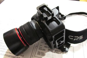

An L-bracket for your body (and a lever clamp if you want to change more quickly) is an option.
Jim
+ 1 for L Bracket =  www.kirkphoto.com
http://www.kirkphoto.com/L-Brackets.html

Yes I thought this might be the case with the collar for the 135 f/2...no-go. Thanks for that.
The L Bracket looks like a viable option. I'll check that out.

Thought you had an L-bracket already, for some reason.  It's not as fast as a collar, and a little cumbersome on a monopod, but definitely what I'd try first (and what I use with non-collared lenses).

+1 - was about to say L bracket and portrait grip as well...

its a light lens why not just use an L bracket on your body?
thats what I do anyway
