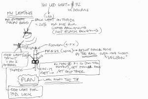

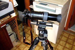

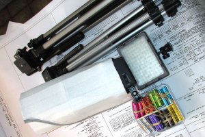

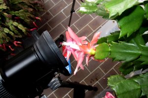

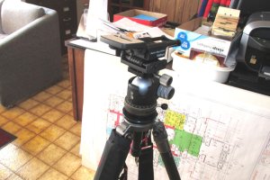

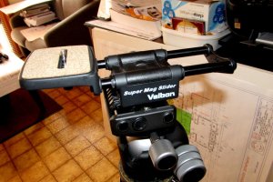

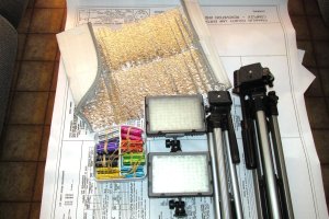

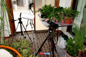

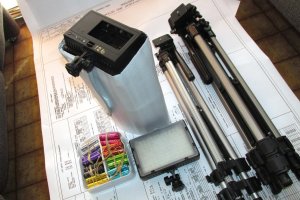

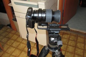

Dear friends.
I have most of Canon Macro Lenses ( 100, 100 L IS, 180 mm L  and MP-E65 mm.), and Most of Canon flashes for Macro Photography.
But for this Extream Macro Photos at 1-5 X, The Front of the lens almost touch ( 1/4 " to 1/2 ") the subject, Any Flashes, Ring Flashes or Ring LED are not good enough for me ( Just my IDEA), I have to Adapt my LED Light Panel( $ 31 US Dollars) with The Cheap Snoot ( the Sun Shield from the Car, with Velcro= Less than 2 US Dollars ) , for Pin point the Bright Spot Light to the Tiny Subject , to get the Super High Shutter Speed and Small Hole of F -Stop at F = 16,  For Bigger/ Thicker  DOF of Tiny Subject.
Yes, Just Only my IDEA of Cheap Side Light to make the Macro Photos look Better.
Enjoy
