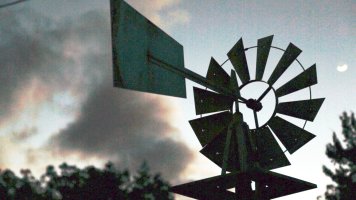

Hello everyone,
I have been shooting with the Mk3 for a few months now, but have recently started seeing some grain in my images. I'm not really sure if it is something on my end causing this, or if it is within the camera. The attached image is a screen grab from a clip I shot wide open at f4 (24-105mm L) with an ISO of 800. The footage gets incredibly grainy when I sharpen in post and I'm not sure why. Could it be that the sky is out of focus? Should I have shot it at a much smaller fstop to avoid this? Any help would be very much appreciated. I'm still pretty new to videography, but I feel I should be getting much cleaner images than I have been. Thanks!

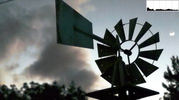

The histogram of the image above:
As you can see, all the information contained in the two darkest segments (5 darkest stops)
This means that you wasted 87.5% of the information.
It looks grainy because of the lack of information and the inaccuracy of the photon count. If you try to bring up the exposure it will look noisy even at a low ISO.
The darkest parts lack the most information, it cannot be effectively recovered. Below you can see how much information can be recovered and how much is lost. First image a quick manipulation to show the really noisy parts with very little information. The second picture a more realistic attempt at pushing the image as far as it will go.

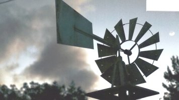

You didn't post EXIF. If you don't post more information, we can't help you. What settings did you use? Choosing your ISO correctly is also important, some lower ISOs can actually be noisier than higher ISOs. One way to get cleaner video is to
 expose brighter
 and then bring the brightness down in post and push the blacks to crush the noisy shadows:

Your clip is simply underexposed. Expose it properly and you'll be fine. There's no way to fix a shot like that. And shooting All-I won't make any difference. Underexposed is underexposed. Additionally, shooting All-I is overkill for web video and the like. IPB is fine unless you're shooting for theatrical projection.

To minimise noise in video using any Canon DSLR shoot with your ISO set in multiples of 160 (so 160, 320, 640, 1250 etc). This makes a surprising amount of difference.
However, in the example frame you've posted, the issue is that the shot is seriously underexposed. Ultimately you can't push a heavily compressed 8-bit video image in the same way you can a 14-bit RAW still (and you'd be pushing it with the level of underexposure in the frame you've posted even it was RAW).
