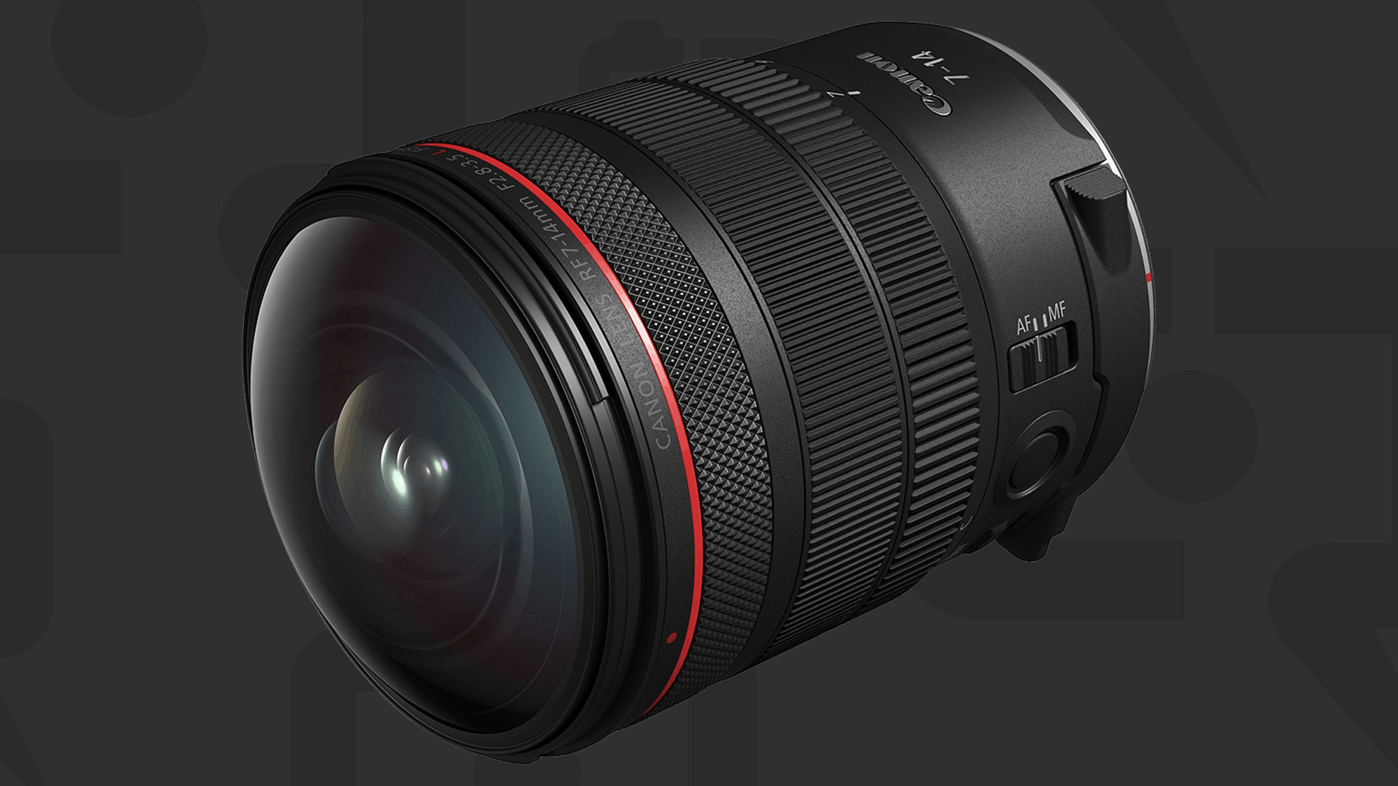

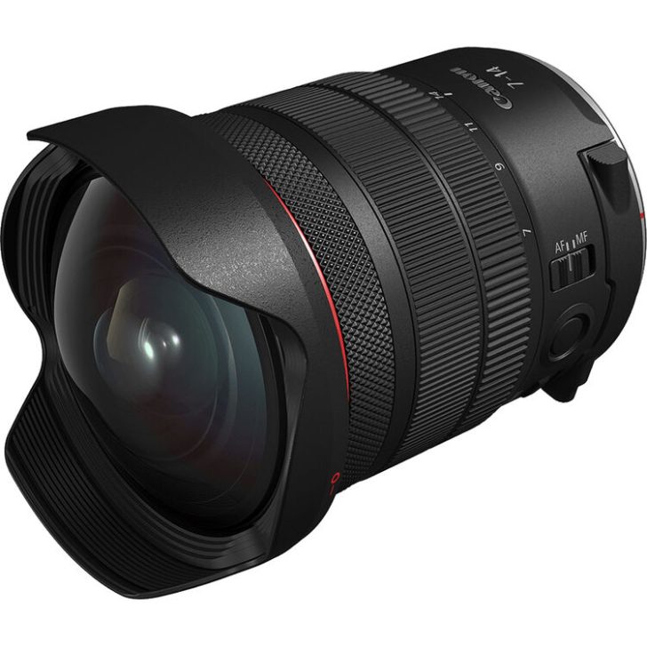

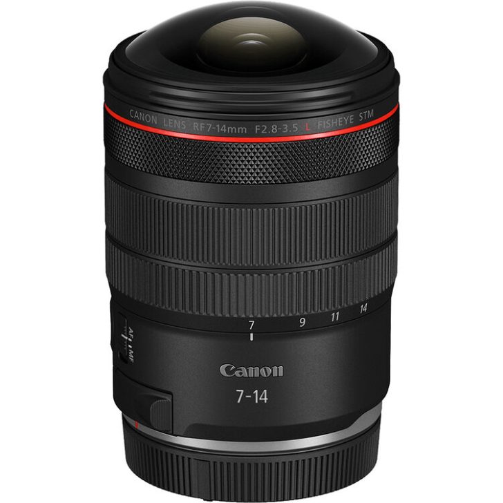

Canon RF 7-14mm f/2.8-3.5L STM
Canon today has announced the Canon RF 7-14mm f/2.8-3.5 fisheye zoom lens. It’s been a long time since Canon shocked the industry with the Canon EF 8-15mm f/4L USM – approximately 15 years ago, and this time, Canon said, we can do better. And they did, they made it wider and faster – and the result is an impressive 7-14mm focal range that starts at f/2.8.
This fisheye lens is rather unique as it offers two different flavors of image projection onto the sensor. At the lens’s widest focal length, the lens produces a circular image with a 180-degree angle of view, and at 14mm, the image will cover the entire full-frame image sensor with a field of view of 114 degrees diagonally.

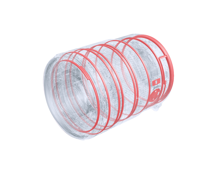

The Canon RF 7-14mm f/2.8-3.5 Fisheye Zoom is weather sealed with an impressive array of seals to protect against moisture and dust ingress into the lens.
As well, the lens features Canon’s fluorine coatings to help you keep water and fingerprints off the large exposed front element. If you are in need of adding filters to this lens, Canon has you covered with a rear filter holder.

Canon RF 7-14mm f/2.8-3.5 Fisheye Zoom Key Features
  • Full-Frame | f/2.8-3.5 to f/22-29
  • Circular/Diagonal Fisheye Zoom, 190° AoV
  • Rear Drop-In Filter System
  • Leadscrew-Type STM Focus Motor
  • Custom Control Ring and Function Button
  • Inner Focus & Zoom, Low Focus Breathing
  • UD and Aspherical Elements
  • Super Spectra and ASC Coatings
  • Rounded 9-Blade Diaphragm
  • Weather-Sealed Design & Fluorine Coating

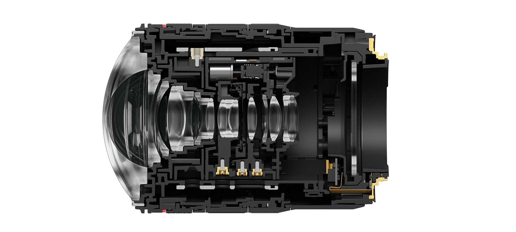

Lens Construction and MTF
We get to take a look inside this lens with another laser-cut-in-half image, and as well, even more interestingly, get to see how the elements zoom from one end of the focal length to the other. Enjoy, it’s rather hypnotic.
Canon RF 7-14mm f/2.8-4 Fisheye Zoom

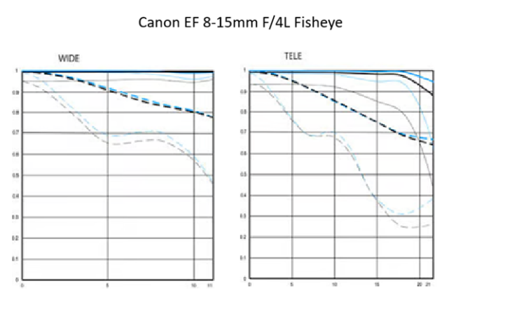

Since Canon did at one time make the Canon EF 8-15mm Fisheye, we can compare the MTFs to see how Canon has fared in fisheye zoom optical designs over the last 15 years.

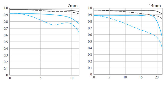

Canon Japan has released the MTF diagram for the Canon RF 7-14mm Fisheye, and it does not disappoint. In terms of contrast across the field of view, the lens will achieve a much greater level of contrast, and as well, the resolution of the lens across the frame is also greatly improved. The resolution tails off after 20mm on the widest part of the frame, because it’s, well, a fisheye, and there’s bound to be some resolution loss at the corners. This is certainly a remarkable improvement over it’s predecessor.

  1. The MTFs you posted for the discontinued EF 8-15 are old versions, calculated differently, and not allowing for diffraction. Here are the ones Canon replaced them with:
    Ah thanks! Was very quickly romping through the internet, pulling it all together this morning / afternoon - and missed the new ones.

    Looking at the cutaway view of the new RF 7-14mm, it's apparent that it is a reuse with minor modification of the EF 8-15mm optics (block diagram superimposed), meaning the lens needed the 'adapter' (spacing) anyway...so why not include a drop-in slot?
    I was hoping for a drop-in slot on the RF 14/1.4, but clearly there is not enough room as the barrel is packed with glass. IMO, the inclusion of a drop-in slot in a non-telephoto lens means that the design is really not taking advantage of the short RF flange focal distance. I suspect that means we won't see this feature very often.

    Comparing the MTF diagrams of the RF lens vs. the EF version, the RF performs much better, and although the optical construction at first sight may look similar, several elements are clearly different (RF: 16 elements, 11 groups, 2 aspherical, 5 Ultra-low Dispersion (UD) vs. EF: 14 elements, 11 groups, 1 aspherical, 1 UD) - which I suppose explains the marked improvement in performance.
