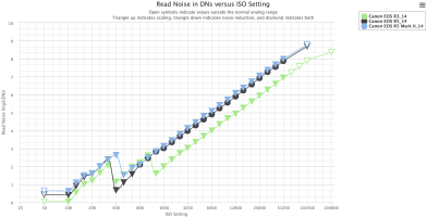

  8. I also discovered what appears to be a second base ISO on the R1.
    Are you suggesting true dual base ISO, or just multiple amplifier stages. The latter is not new.
    • 0

  11. Are you suggesting true dual base ISO, or just multiple amplifier stages. The latter is not new.
    Looking at the noise pattern at 300% zoom, there is a noticeable reduction in noise at ISO 1600.
    • 0
  12. Looking at the noise pattern at 300% zoom, there is a noticeable reduction in noise at ISO 1600.
    The R3 has reductions in read noise at ISO 400 and again at ISO 1250. The ISO values at which the amplification changes does shift from model to model, e.g. the R5 has one drop at ISO 400 while the R5II has that drop at ISO 500. Still not convinced you're seeing something new.

  13. The R3 has reductions in read noise at ISO 400 and again at ISO 1250. The ISO values at which the amplification changes does shift from model to model, e.g. the R5 has one drop at ISO 400 while the R5II has that drop at ISO 500. Still not convinced you're seeing something new.

    FYI, he doesn’t actually test cameras himself. Users send him raw files to his specifications and he tests those. Sort of a crowd sourced effort.
    Currently, according to Photons to Photos, the R6ii / R8 is best low iso performer in the Canon range with the R3 coming in a close 2nd place.
    The R3 is 0.4 stops better at ISO 100. The R62/R8 is slightly better from ISO 200 to 800 (with the biggest difference of 0.3 stops at ISO 320), then the R3 is slightly better the rest of the way up.
    I would say that means a very slight edge for the R3 as differences of less than 1/3-stop aren’t considered significant.
